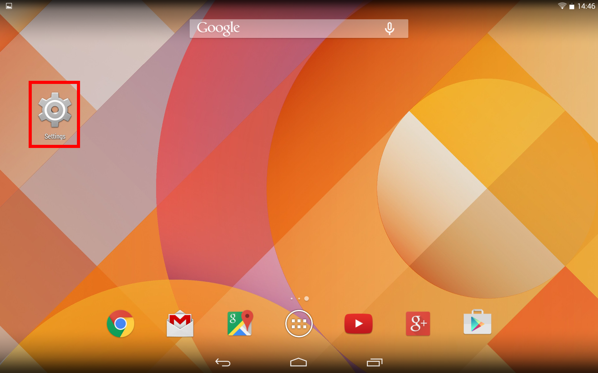

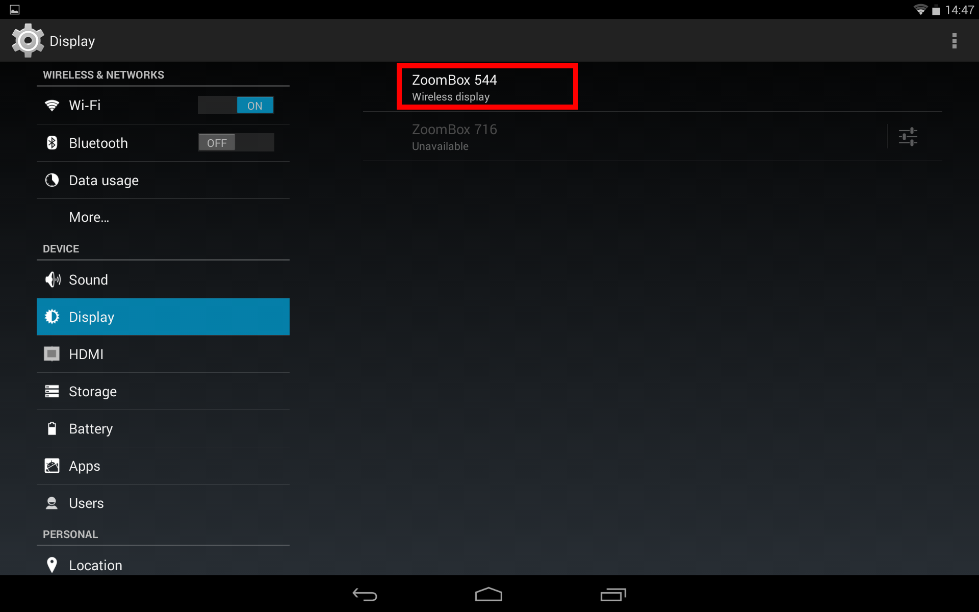

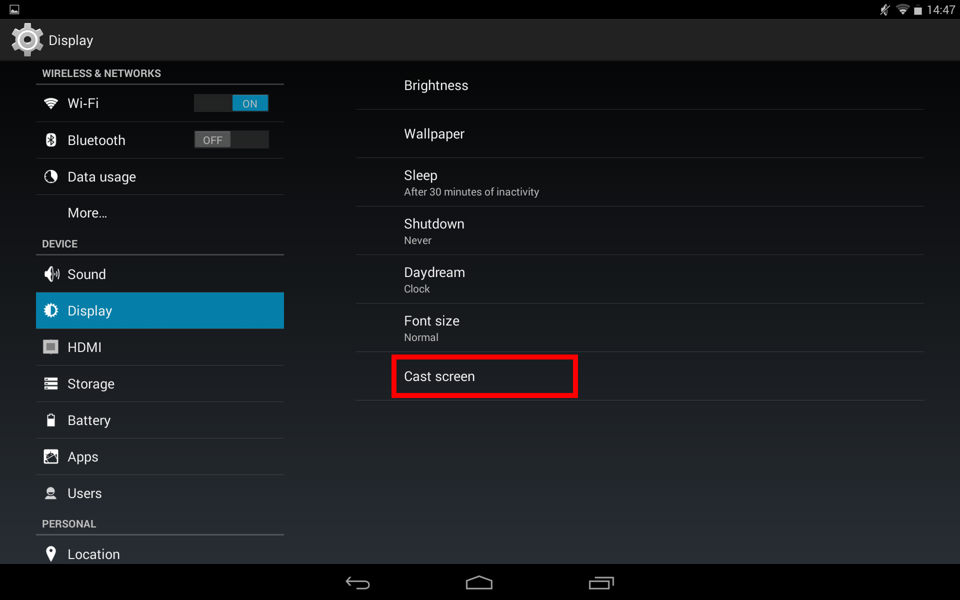

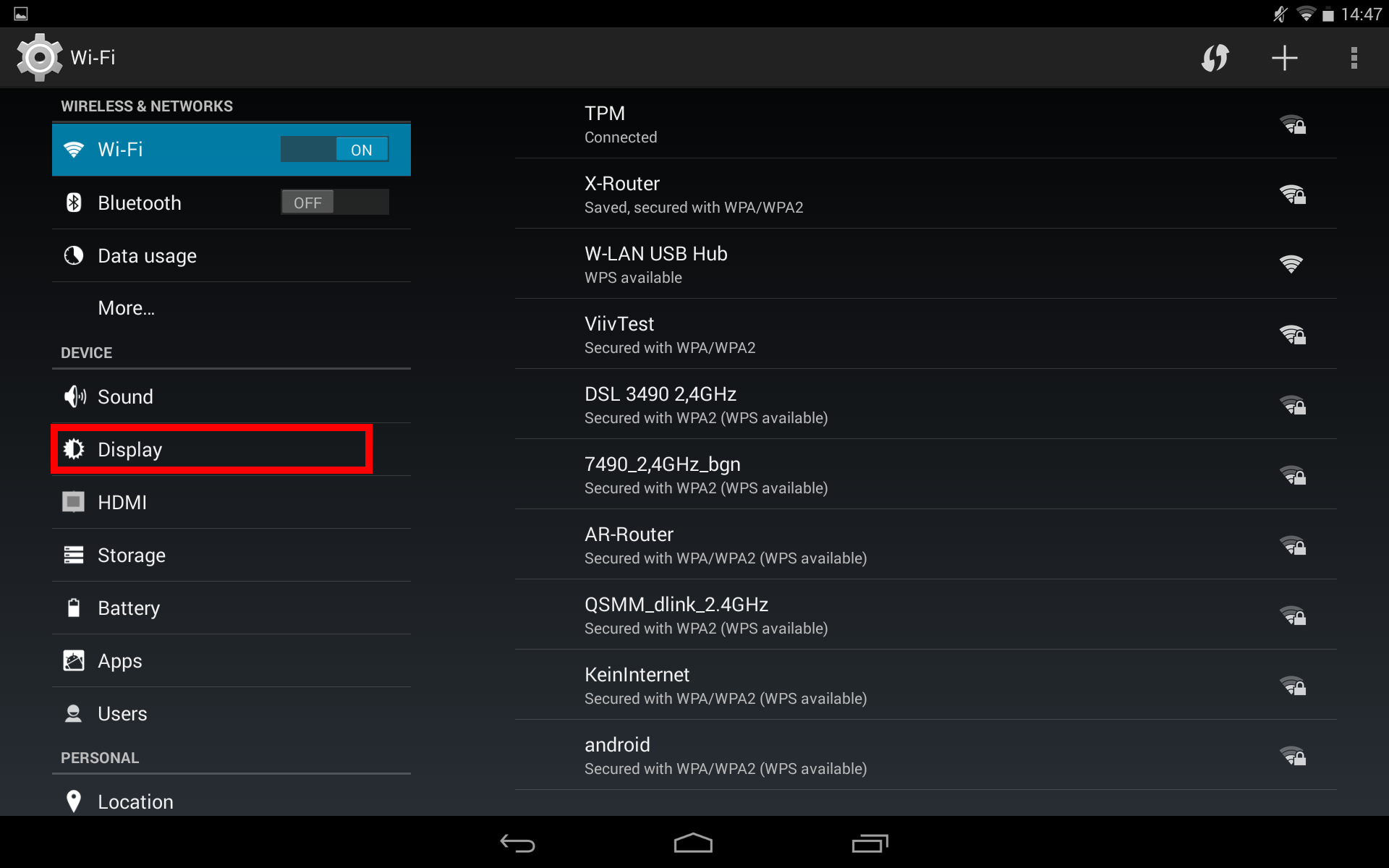

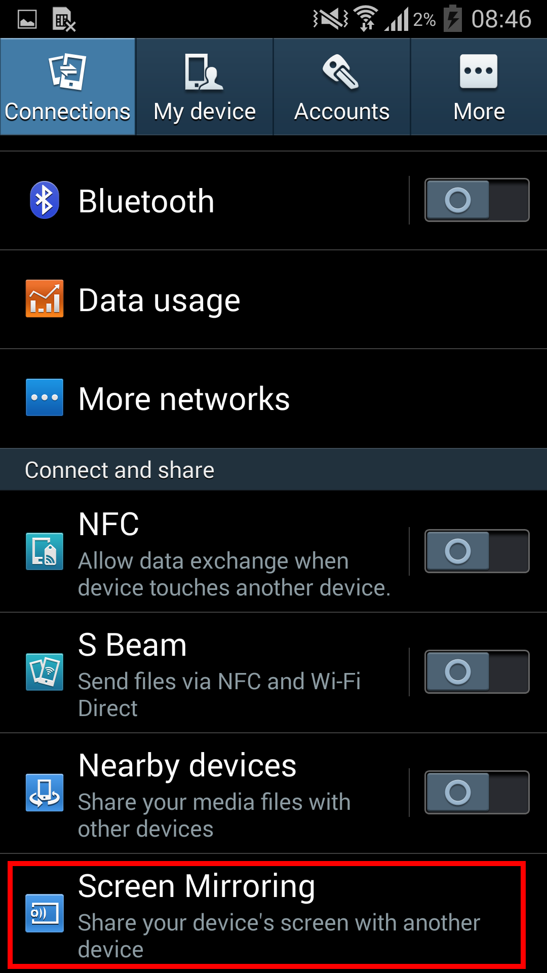

Step 1: Open the settings menu on your smartphone/tablet
Step 2: Open the display settings on your device
Step 3: Activate the "Screen Mirroring" option

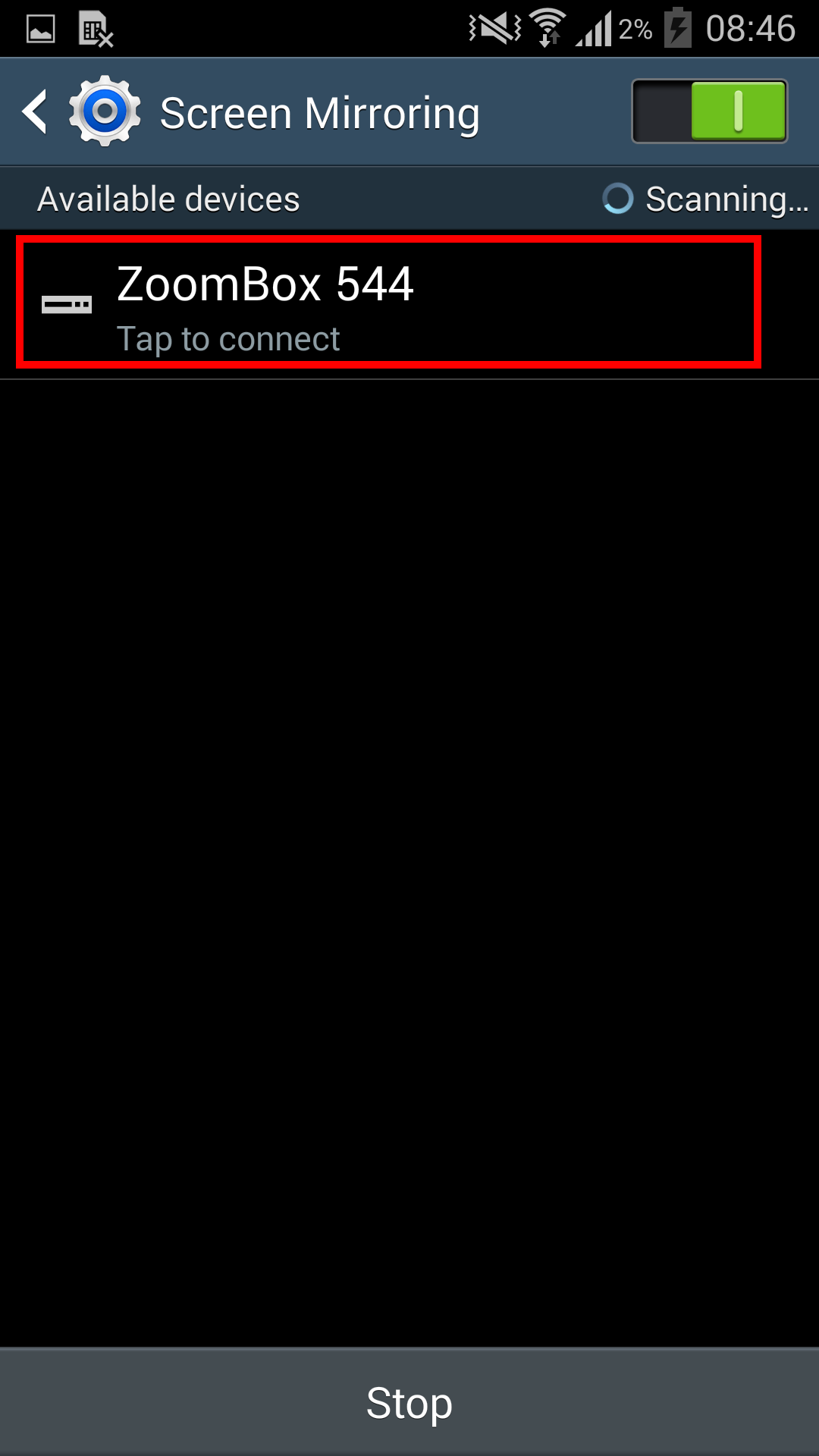

Select the ZoomBox.

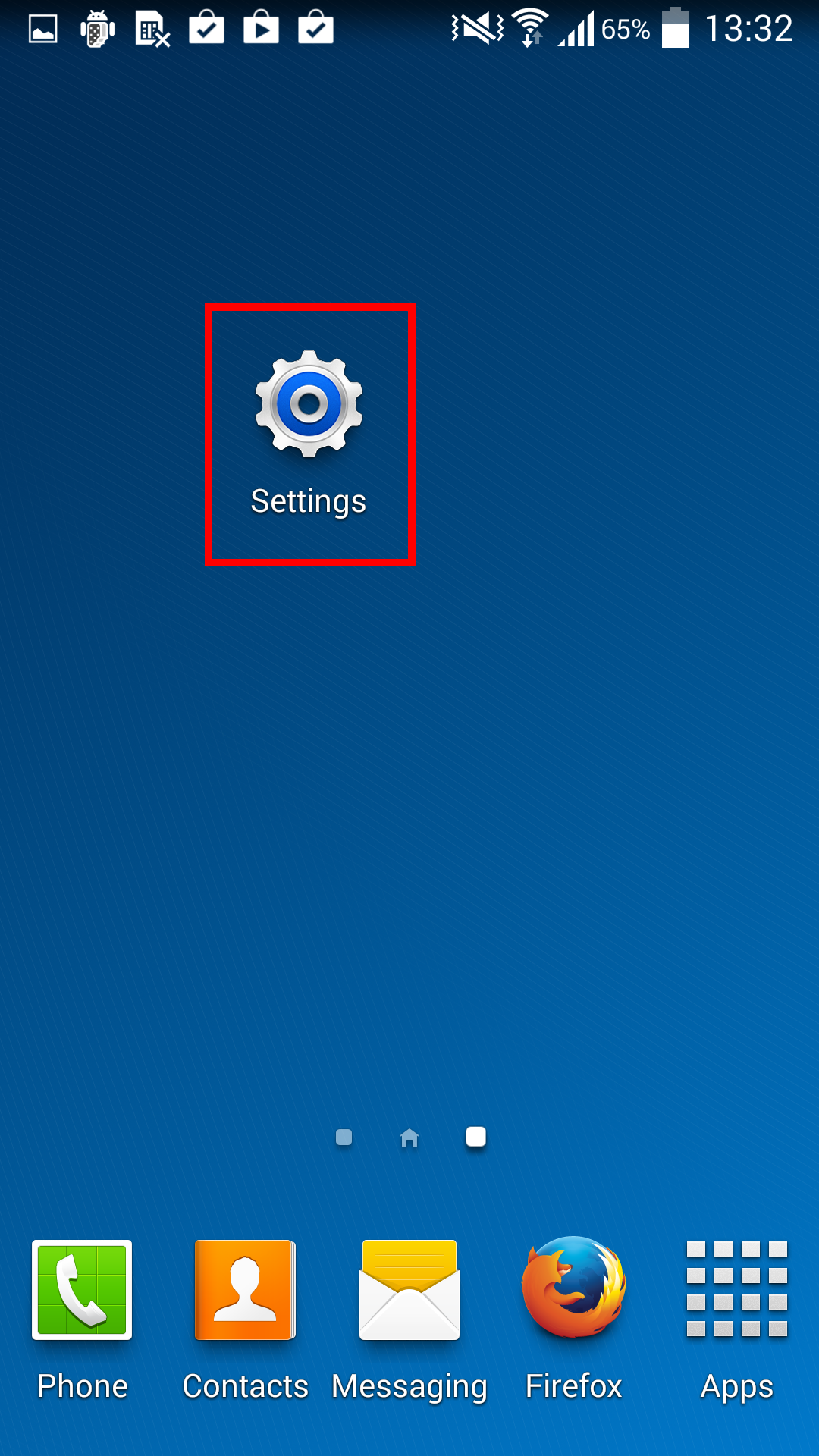

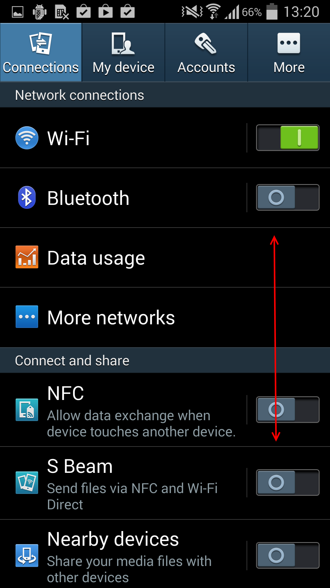

Step 2: Scroll down to the "Screen Mirroring" option
Step 4: Select the ZoomBox.

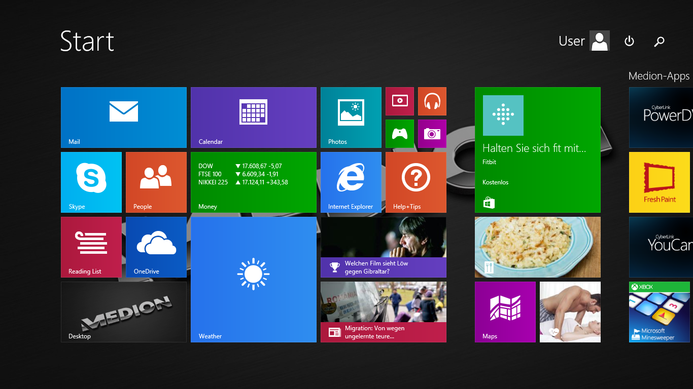

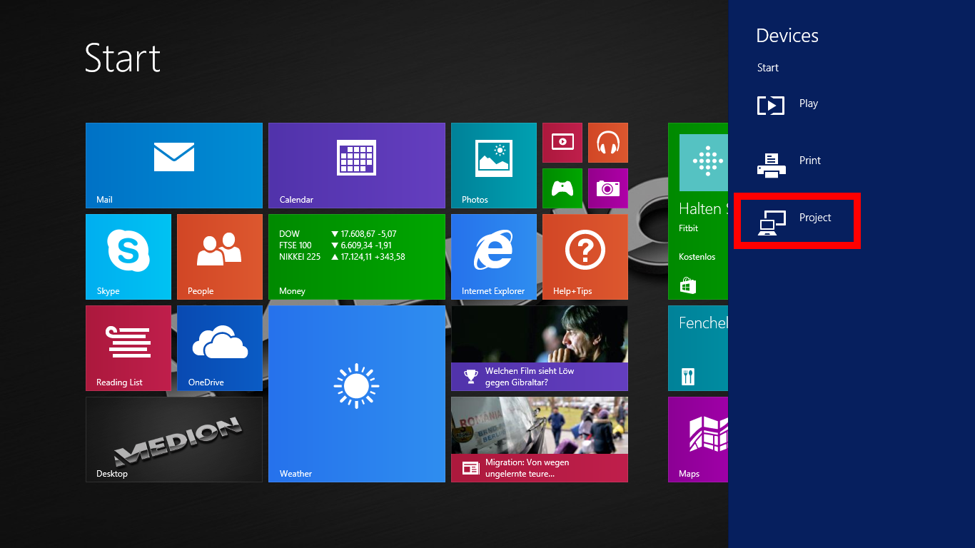

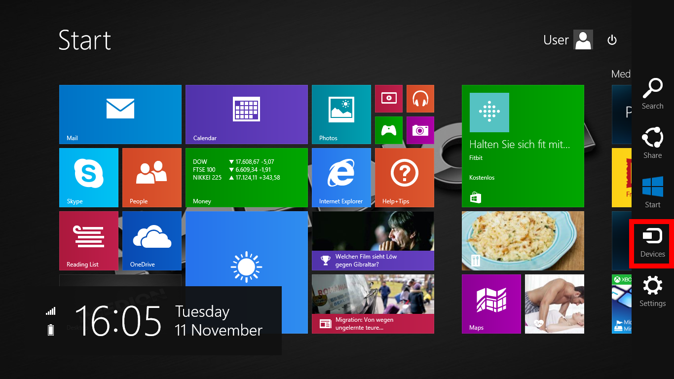

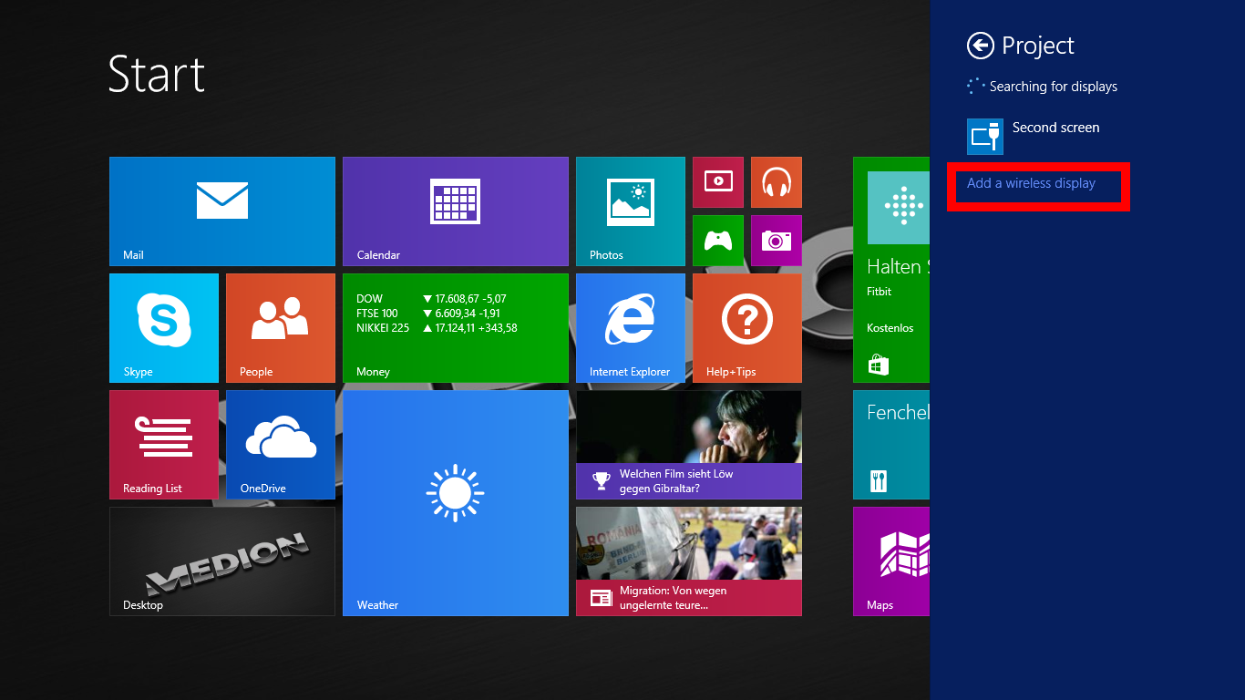

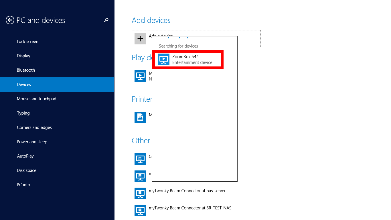

Click on your user name.
Open "Devices".
Click on "Project".
Activate the "Second screen" option.
Add "WFD 909 Entertainment Device" as a "Device".
